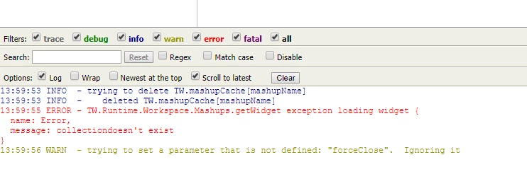

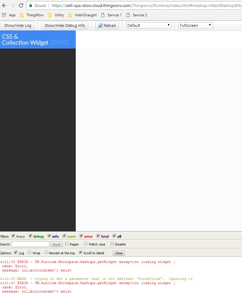

Hi all,
I would like to use this new widget, but it seems there's some problem. I tried to follow the tutorial but when I view mashup it return blank and the console show the message error "collectionwidget doesn't exist".
I also tried to install with success the css collection bundle following this instruction:
https://community.ptc.com/t5/Talkin-ThingWorx/New-in-8-2-Collection-and-CSS-Editor/gpm-p/535064
but the result is the same.
Someone can help me?
22-Sapphire I
Aug 13, 2018 4:32 PM UTC
What version of Thingworx are you using?
Aug 14, 2018 6:32 AM UTC
Version : ThingWorx 8.2.5-b260
22-Sapphire I
Aug 14, 2018 2:07 PM UTC
Can you try emptying your cache? Not sure if for some reason it is not properly loading because it thinks all content is already cached.
