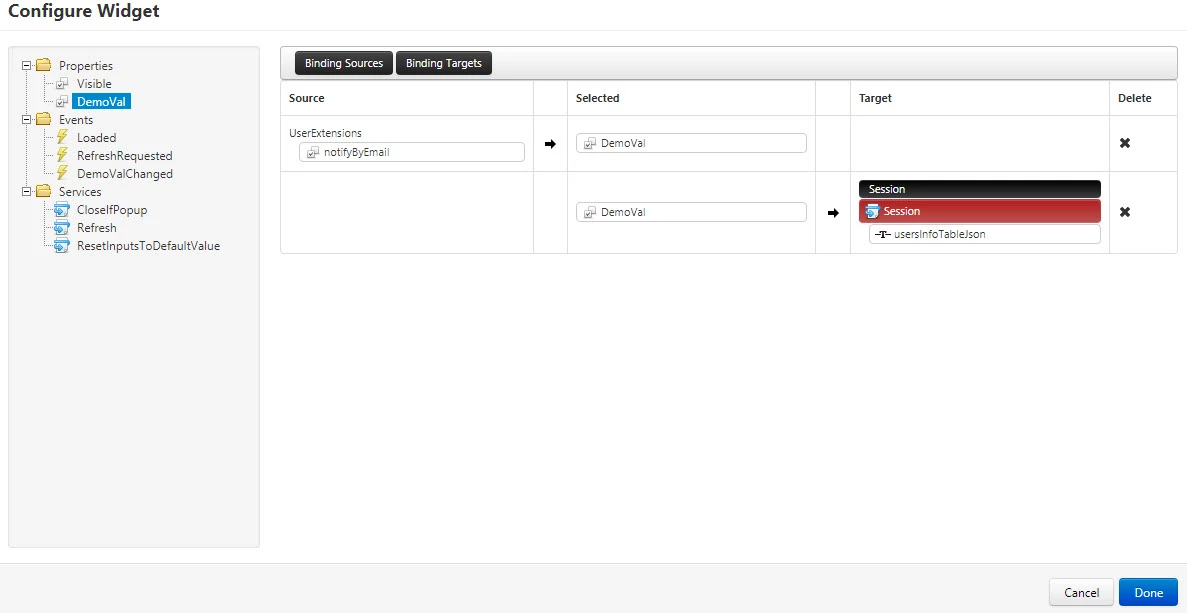

I need to bind value to mashup parameter for Collection widget. How to bind source for the same
Mar 6, 2018 2:59 PM UTC

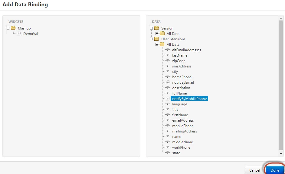

Hi @csimhadri not sure if I got your use case right. But if you are looking to bind parameters to mashup you'd need to select the Mashup Widget and then from the Data select the property that you want to bind with. Here's a very crude example where i have added  custom property of type boolean to the mashup and i am binding it to the another property of type boolean. See attached screenshots for reference.

Thank you @supandey for your quick response. Actually I'm looking for the solution to bind parameter which is coming from previous mashup. i.e. Mashup Parameter.
Mar 7, 2018 10:11 AM UTC
Well I think the process will remain the same, if this source mashup, i.e. the mashup from which you want to bring in the property value, is a contained mashup in your target mashup you can still select that mashup's property in the Binding Source
In case if this isn't a contained mashup, you can use this method defined in the article How to pass a parameter to a mashup from a hyperlink / URL in ThingWorx
