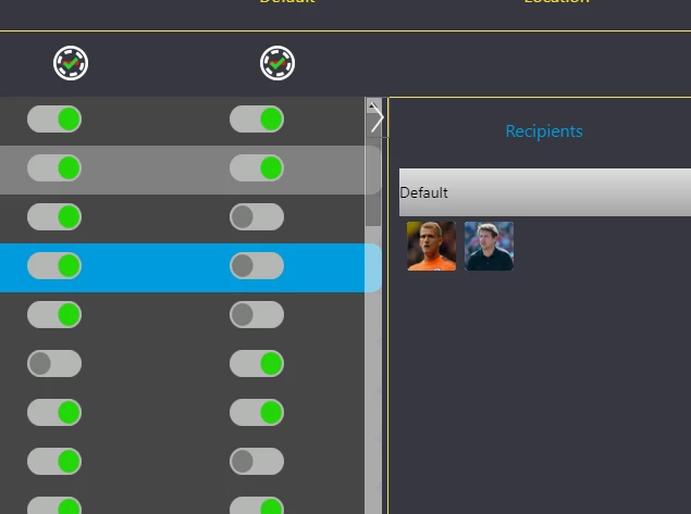

I have a couple of issues with the collection widget which I'm hoping someone may have an answer to.
  1. I have a collection widget in a sidebar (RHS), which is populated via a service on a SelecetedRowsChanged event from another service. What I notice is that if the sidebar is collapsed at the start (when service originally called) but then expanded manually the collection widget never draws no matter how many times the SelecetedRowsChanged fires. However, if the sidebar was expanded to start with then it works correctly. Seems like I need a widget 'refresh' but can't find a way to do this.
  2. The second issue is similar in that to the left of the sidebar mentioned above I have a second collection widget. The sidebar has the 'Overlay' property set to false. What I see is that when I expand/collapse the right sidebar the collection widget to the left does not resize itself to take advantage of the new space, but retains its original size. Again it feels like I need a refresh somehow.
Aside: If I resize the window/browser the collection widget does resize as expected.
thanks in advance
K
