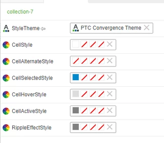

I am using a Collection widget, with the following styling:
But for some selected cell or hover styling, colouring is not working or is not showing up.
Thingworx version: 9.4
Best answer by Constantine
Sorry, used a wrong word -- "Try to make cell mashup's background transparent instead of white."
Does that work?
/ Constantine
18-Opal
August 29, 2025
Try to make cell widget’s background transparent instead of white.

pshashipreetham
September 11, 2025
Not the solution I am looking for, I will keep this post open
