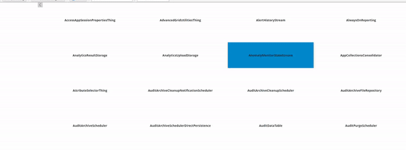

Hi all,
I have a collection widget with selection enabled. Whenever I expand the side container, the selected row gets refreshed (Refer GIF)
During this event, we are not able to select anything in mashup. Is there any way to solve this issue
TWX Version : 9.0

Hi @Velkumar.
Do you have the overlay option selected in the properties panel? You can try selecting that to see if it behaves the way you're expecting.

December 2, 2021
Hi @Velkumar.
To confirm, you're saying that you can't do anything while the container is expanding, but it works as expected once it has expanded?  How long until it becomes responsive again?

Velkumar19-TanzaniteAuthor
December 3, 2021
It takes 5 - 10 seconds to expand

Hi @Velkumar.
