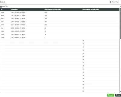

I am taking logged data from 10 properties of 10 things. I am using the "QueryNumberPropertyHistory" service to fetch logged property data for things. The output infotable contains "id, timestamp, value" fields. I tried to combine two infotables by using the "Left Join" query. But when I tried to use the same query to combine three infotables, it wouldn't work.
Can anyone please help me achieve the required output?

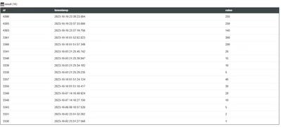

The union function combines data from two tables, as shown in the below image.
My requirement is quite different. I want separate columns for each machine, as shown in the below image. The FULL JOIN shows me data in the below format, but this is not accurate.
I have also replicated the same code mentioned by you in the previous email, but it is adding entries one below the other.
