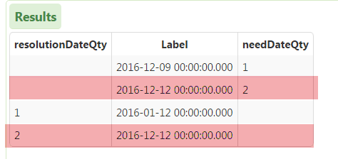

Replying my own question, so maybe you guys want to comment in my approach and help me were I got stuck: after a cup of coffee I decided to take a fresh look at this , and came up with a different approach.
  1. As both tables are generated by the same service with a different parameter, they both have the same field;
  2. I ran the service for generating each table and renamed the Value field to match its respective parameter;
  3. I then added a field to each table for the other parameter so both will have the same DataShape
  4. I then used UNION to combine both tables.
The issue I am running to is that now I have duplicate values for the common Column.
I tried to use the COMBINE method but did not figure it out yet.

December 28, 2016
