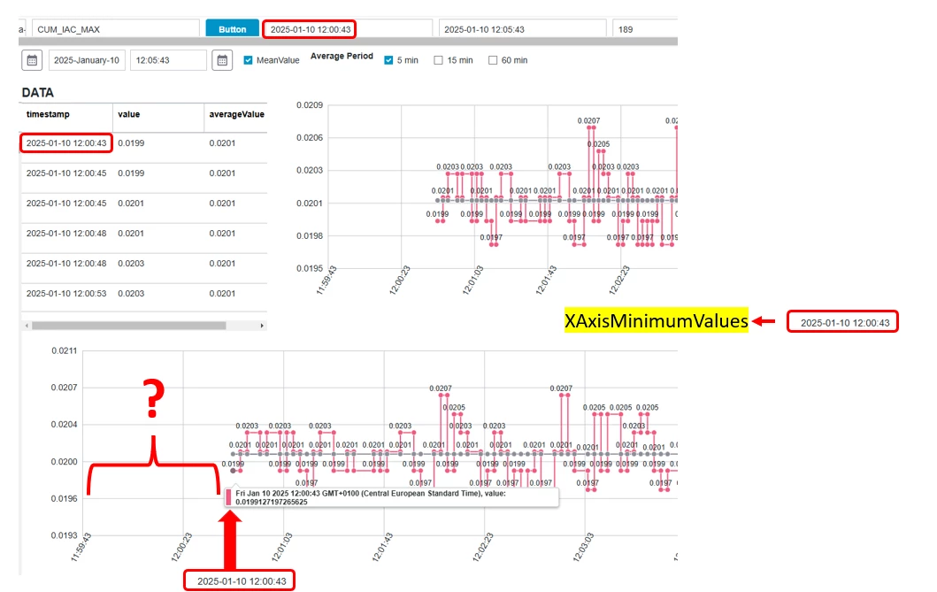

We use a Combo Chart in Thingworx 9.6.
I sent the widget the minimum timestamp value.
However, the widget uses a different minimum timestamp value, in general it seems to use an indefinite value of about 10 minutes.
Does anyone have any solutions?
BR
Dimitri
dbologna13-AquamarineAuthor
Jan 10, 2025 11:33 AM UTC
I send a further image of the problem
BR
Dimitri

Hi @dbologna,
I'm not sure but I guess this can a bug of Combo Chart. What if you don't bind and set XAxisMinimumValues and XAxisMaximumValues?
Just query and return the datasets that fall in the specified timestamp range and populate it to the combo chart, let the system calculate the min and max x value automatically to see if the chart plotted meets your requirement.
Best,

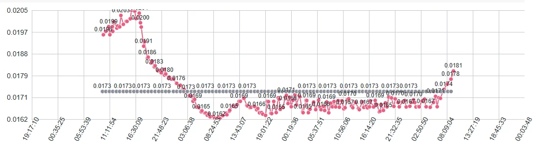

Jan 13, 2025 8:46 AM UTC
Thank you Tony,
if I do not assign the values XAxisMinimumValues and XAxisMaximumValues, the widget presents empty areas on both the left and right of the graph as in the attached figure.
I don't understand the problem (unless it is a bug), the strange thing is that on the right-hand side XAxisMaximumValues works correctly.
Thank you
Dimitri
