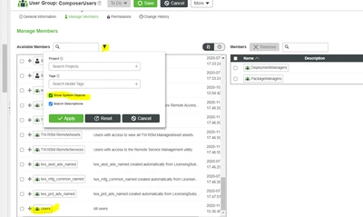

@AP_9587236 When trying to add back the 'Users' group, check the Show system objects filter as per below snapshot. Then Users group would be visible and can be added back.
