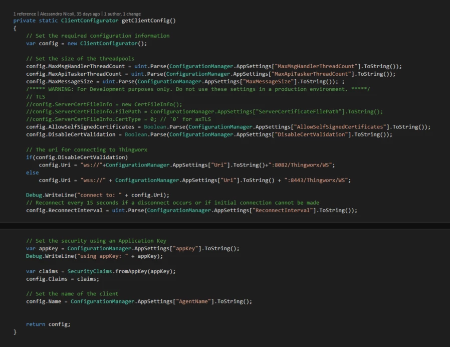

2 - the client has been configured this way, using a config file for edit connection's details.
(ATTACHED_2)

Ideally the server would provide it's public key and the intermediate CA key as well to build a route of trust to a known root.   If you have no known roots in your environment you would need to provide that to the end device.
Are you using a self-signed certificate?  Is so, the following properties are set to true, I assume:
  • ClientConfigurator.AllowSelfSignedCertificates = true
  • ClientConfigurator.DisableCertValidation = true

Hi, yes my configuration is:
// TLS
 CertFileInfo serverCertFileInfo = new CertFileInfo();
 serverCertFileInfo.FilePath = ConfigurationManager.AppSettings["ServerCertificateFilePath"].ToString();
 serverCertFileInfo.CertType = 1; // '0' for axTLS
 config.ServerCertFileInfo = serverCertFileInfo;
 CertFileInfo clientCertFileInfo = new CertFileInfo();
 clientCertFileInfo.FilePath = ConfigurationManager.AppSettings["ClientCertificateFilePath"].ToString();
 clientCertFileInfo.CertType = 1; // '0' for axTLS
 config.ClientCertFileInfo = clientCertFileInfo;
 KeyFileInfo keyFileInfo = new KeyFileInfo();
 keyFileInfo.FilePath = ConfigurationManager.AppSettings["ClientKeyFilePath"].ToString();
 keyFileInfo.Passphrase = ConfigurationManager.AppSettings["ClientKeyFilePassphrase"].ToString();
 keyFileInfo.KeyType = 0;
 config.ClientKeyFileInfo = keyFileInfo;
 config.AllowSelfSignedCertificates = Boolean.Parse(ConfigurationManager.AppSettings["AllowSelfSignedCertificates"].ToString());
 config.DisableCertValidation = Boolean.Parse(ConfigurationManager.AppSettings["DisableCertValidation"].ToString());
For the certificates, I'm using self-signed and I created them for the CA, .NET Application and TW Tomcat.
1- On the tomcat I've already set up the server.conf, indeed I'm able to use HTTPS by Chrome)
2- Chrome shows it as trusted, since I added the CA cert to my Windows (Client) trusted roots.
3- Actually i don't wanna validate Client cert on the server, just validate the Server.
3- I'm not able to connect with Thingworx over WSS since on the client it gives me back this error: "com.thingworx.communications.client.TwApiWrapper Error: 0 : [Error] twWs_Connect: Error trying to connect"
