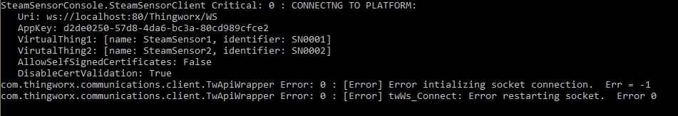

Received this question from a user. Thoughts? Thanks in advance.
Error -1 during socket initialization:

This looks like the connection to the socket fails.
Is the Thingworx environment on localhost running with a self signed certificate?
If yes, please ask the user to change the Uri to wss://localhost:8443/Thingworx/WS and let me know if this resolves the problem.
At first glance it looks like the connection is refused.

I think you are on the right track.  I am trying to connect to a trial version to do development and testing.  When I ping our (purchased) live Thingworx  core it connects and pushes property updates.  When I installed the trial version I did not select SSL secure connection because I do not have a KeyStore.jks file or the KeyStore password.
