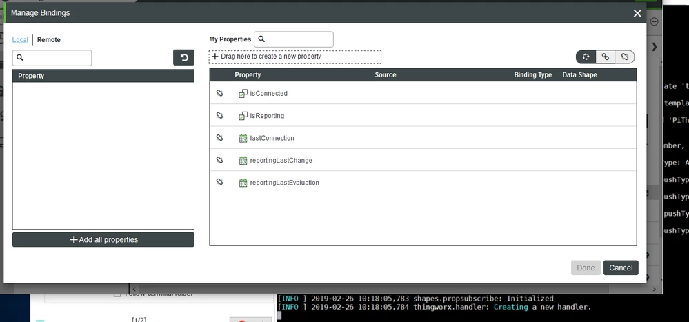

I'm fairly new to Thingworx and trying to get some first steps done by connecting a Pi to Thingworx, following the
Raspberry Quickstart guide. (https://developer.thingworx.com/en/resources/guides/thingworx-raspberry-pi-quickstart/)
EMS is 5.4
I'm using a own thingworx installation.
First my config.json:

However runing the LUA script does result into it beeing stuck at crating a new handler(EMS does run):

[INFO ] 2019-02-25 12:24:36,872 thingworx.handler: Creating a new handler.
In Thingworx the PiThing is connected but without the Properties like cpu_temperature e.g.

did I miss sth. at the PiTemplate.lua?
Any help appreciated!

Solution:
Step1:
Update the EMS to 5.4.1 or higher.
link in Guide refers to 5.4.0 which causes the Problem.
just Download the latest Version from PTC.
Step 2:
in the PiTemplate.Lua
is a Typo:
module ("templates.PiTemplate", thingworx.template.extend)
properties.cpu_temperature = {baseType="number", pushType="ALWAYS", value=0 }
properties.cpu_freq = {baseType="NUMBER", pushType="ALWAYS",value=0 }
it needs to be changed into NUMBER.

Hi @MHaas1.
Did you set up the bindings in ThingWorx (step 10 from the instructions)?  Until you have bound the entity/properties with the corresponding ones from your remote thing, you won't see anything in ThingWorx.
Regards.

Hi Sharon,
Thats where i get stuck. Below a Screenshot from "Manage Bindings" Button.
after some time the "Service GetRemoteMetadata has timed out" Message appears.
Regards
Moritz
*Edit1: Screenshot
