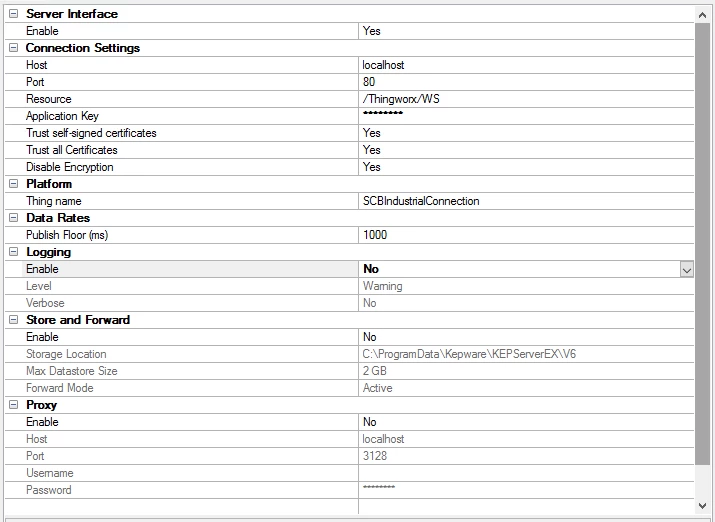

I'm unable to create a connection between KepServerEX V6.7 and Thingworx v8.5, both running locally on the same machine.
I have tried the recommended troubleshooting to no avail:
1.Verify that the host, port, resource, and application key are all valid and correct. Confirmed.
2.Verify that the host machine can reach the Composer on the ThingWorx Platform. Confirmed.
3.Verify that the proper certificate settings are enabled if using a self- signed certificate or no encryption. Confirmed.
The KepServer logs give me the following error: TW SSL_VERSION: Error tls runtime version: OpenSSL 1.0.2s-1 28 May 2019, does not match compiled version: OpenSSL 1.0.2j-3 26 Sep 2016
For background, I am using the 'org.apache.coyote.http11.Http11AprProtocol' protocol.

From the notes in the case, it appears the issue was solved by making the following config changes in Kepware:
  • Trust All Certificates set to true
  • Disable Encryption set to false
  • Connect to port 8443
If you agree that this was the correct solution, please mark this post as the Accepted Solution for the benefit of others with the same issue.

Hi @hughesi ,
Have you tired with disabling 'Trust self-signed certificates' and 'Trust all Certificates'.
/VR

I upgraded KepServerEX from Version 6.7.1046 to V6.8.796 and the OpenSSL error is no longer showing, but it still won't connect.
[WARN] 2020-03-03 15:23:32,125 SDK Version: 2.2.7
[WARN] 2020-03-03 15:23:32,125 TLS Library: OpenSSL
[WARN] 2020-03-03 15:23:32,125 TLS Library Version: 1.1.1d-1
[ERROR] 2020-03-03 15:23:33,161 Error intializing socket connection.  Err = 10061
[ERROR] 2020-03-03 15:23:33,161 twWs_Connect: Error restarting socket.  Error 0
[ERROR] 2020-03-03 15:23:33,161 twApi_Connect: Max number of connect retries: 1, has been reached
Connection to ThingWorx failed. | Platform = localhost:80/Thingworx/WS, error = could not initialize a secure socket connection.
