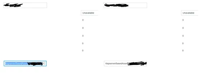

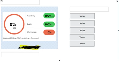

I have a base mashup containing several text fields and value displays and a contained mashup which loads data when the thing name is passed to it. The contained mashup works by its self and on other mashups it is present on.
But when used with the collection widget the contained mashup does not load and I get the message (could not load "MASHUP_NAME" reason 0 undefined"

Carl9851-VisitorAuthor
April 6, 2022
Hi Sharon
You are correct the problem is to do with the layout selection. If the layout is set to static in the base mashup the contained mashup does not display correctly when used in a contained mashup. From my contact with tech support the fix has been tested in 9.3.1 pre release and works
