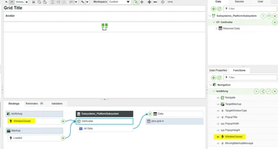

I assume the deletion service worked as expected, which deletes the row from the data source; however, to refresh your main mashup's Grid, you might need to reinvoke the data source service from the contained mashup.
For example, you can use the WindowClosed event to tell the data source service to reload the Grid, that is, to bind the WindowClosed event to your Grid's data source service, such that when you finish operations in your contained mashup and close that popup window, the WindowClosed event will be triggered to invoke a Grid refresh.

Feb 28, 2025 5:03 PM UTC
for easier follow via sample screenshot:
Binding the "WindowClosed" event from the popup, to call the service which provides the data for the grid. So that data is reloaded when the popup was closed.
