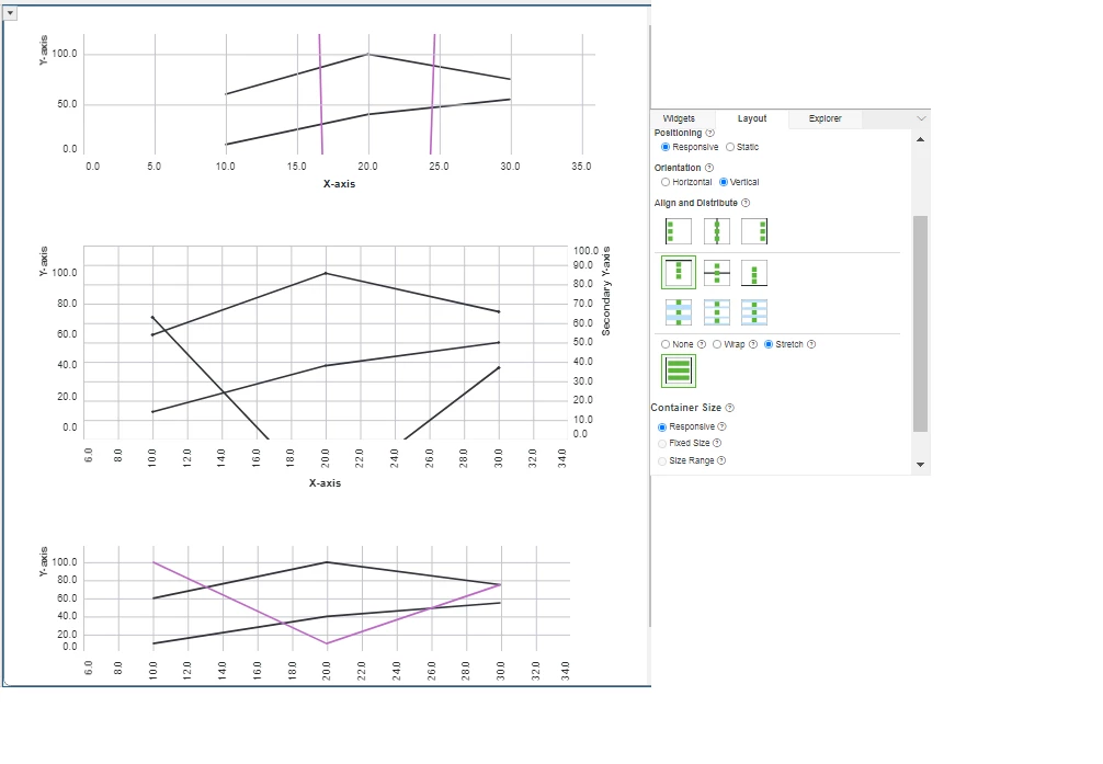

I have a container with 3 graphs one below the other with vertical orientation and responsive. attached image for reference and i am using Thingworx 9.1.
When i make the middle graph visible false automatically the graph from the bottom is coming up to the top.
How do i set the configuration in such a way that, if i make the middle one visible false, the top and bottom should auto use the space created by the middle one , since its made to visible false.

Ok, then try to create expandable container. when middle one is hidden make the container collapse too. That would help.

You better device this container in more child container (vertically). Now put these 3 in each of those container. Now if you are making middle one invisible, that space is going to be there and bottom one won't come up.

I do not want to create that void space when the middle one is invisible, i want to utilize the middle space by the top and bottom graph equally. Its like if 3 graphs are present one after the other, 1st and 3rd  should utilize 1/3 of the space  and middle the rest. But if middle is invisible then both 1st and 3rd should utilize the space created by the middle.
