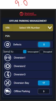

We developed few mashups in TW 9.0 to set to the mobile resolution of 400*800 and it works fine when we do the runtime view.
When exporting this mashup and importing in TW 9.3, the containers are becoming small even if the containers are set to specific fixed size. The same mashup works fine in 9.0 and containers are spaced how expected but in 9.3 the containers gets shrink. Should we set any property in the higher version?How can this issue be resolved?

under Layout you can set "Align and Distribute" to "Stretch" when arranging the parent container. This should fill the screen again.

We tried your suggestion but it isn't working. Please let us know if there is any other solution to resolve this issue?

Is it possible for you to share the mashup in xml including all the related/dependent entities for us to check if there are any ways to solve the issue?
