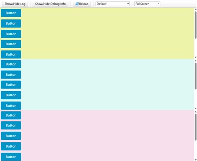

Is there a way to allow rows to be wrapped and push down the row below instead of scrolling?
For example: Create two rows. The first row has 3 columns and is set to wrap. The second row has one column. When the content of the first row is wrapped it always adds a scroll to the container. Ideally I'd like it to push the content of the 2nd row down and display all of the first rows content. This is the behavior when using flexbox on a normal webpage. Is this possible in ThingWorx? Using ThingWorx 9.4.

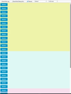

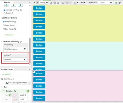

Did you try this feature at container level ? (you need to do it at lower container level - it does not work efficiently with size dynamic widget like collection or grids)
Using this feature I moved from
to

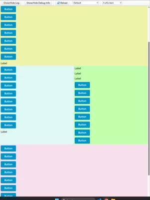

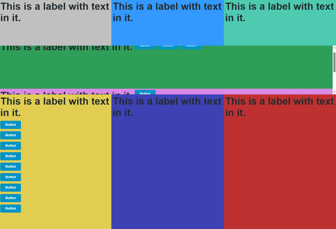

Thank you for the response. Yes, I can recreate what you are showing successfully. I can even wrap widgets properly as well. Where it doesn't seem to work is with wrapping sub containers.
For example: Add several columns to your example on each row. Then for each row set them to wrap. I would expect the container would push the content below down just as the widgets do but it seems to keep the scroll bars no matter what.
Apr 28, 2025 1:58 PM UTC
Even with some column, it seems to work on my side. Did you set every container size as "responsive" rather than "Fixed size" ?
