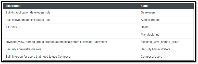

Create a service where you can call
var result = Resources["CurrentSessionInfo"].GetCurrentUserGroups();
It returns an infotable :
Code for your service ( it returns a boolean ). the "userAdmin" string may be passed as a parameter,

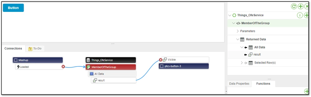

Next, some bindings :
And it works 🙂
And it works 🙂
