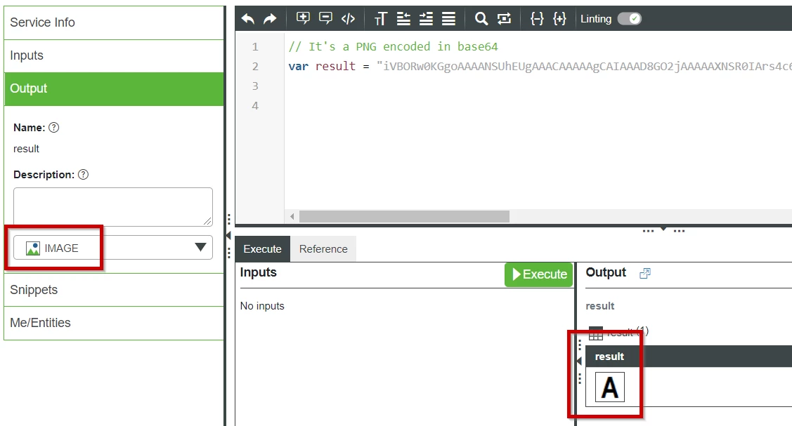

In ThingWorx images which are not stored as files are base64-encoded strings. You don't need to do any conversion if you return IMAGE from your service, see screenshot attached.
