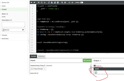

I've created a test service to check if the resolution in the link you shared with me, but failed.
I expected to get original image but image data cannot be  restored.

Yes that's where I had the issue too. But you see in line 12 it changes your binary data and wraps {array:xxx} around it.
After decoding you would need to reverse this operation as well, to get only your xxx back. But I did not try it further for now
