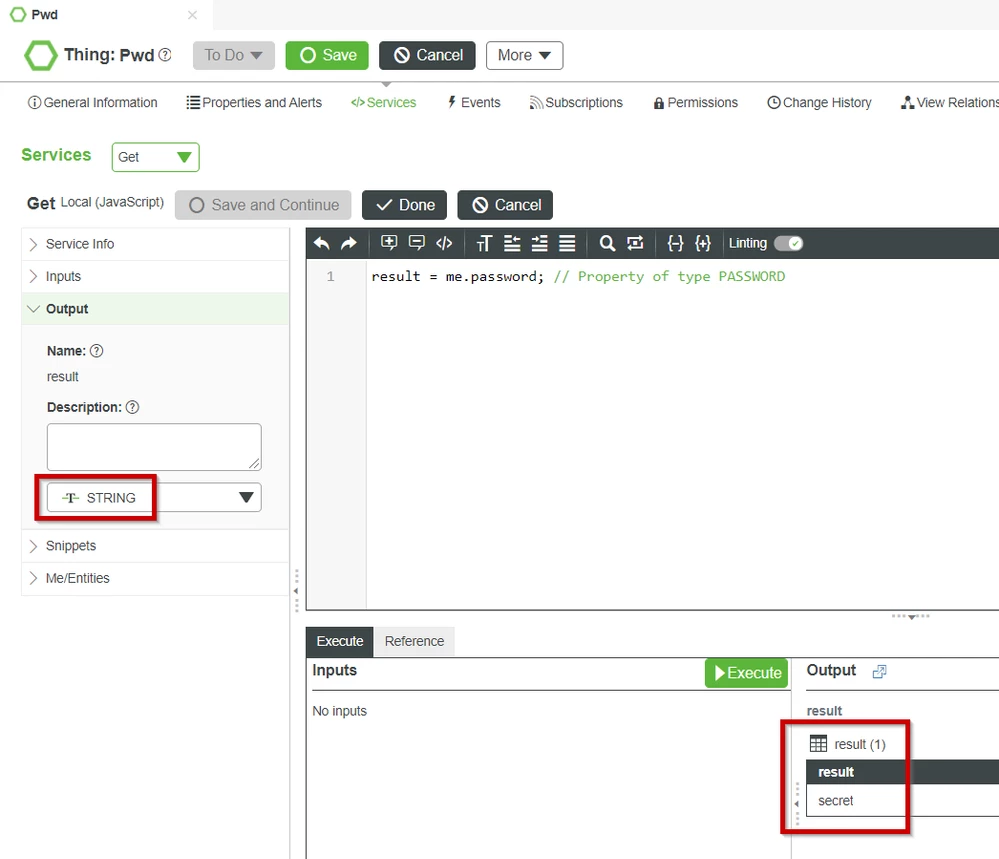

Hello @cbaurand, what about this?

@cbaurand
The community post you found is right.
This is per security policies, you cannot copy it.
Best Wishes!
