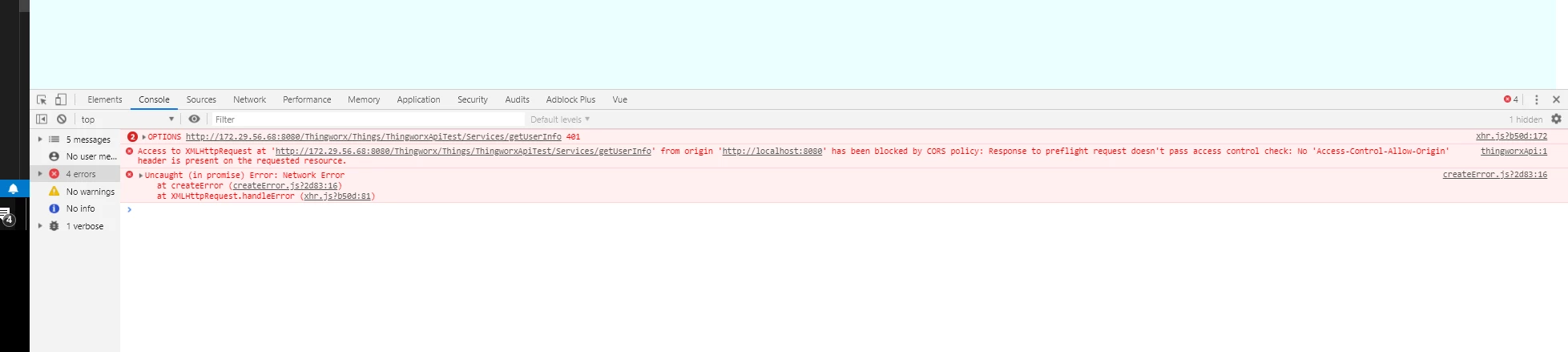

I have already configure my Tomcat serve for CORS still i am not able to access my api and i am getting " Response to preflight request doesn't pass access control check: No 'Access-Control-Allow-Origin' header is present on the requested resource."

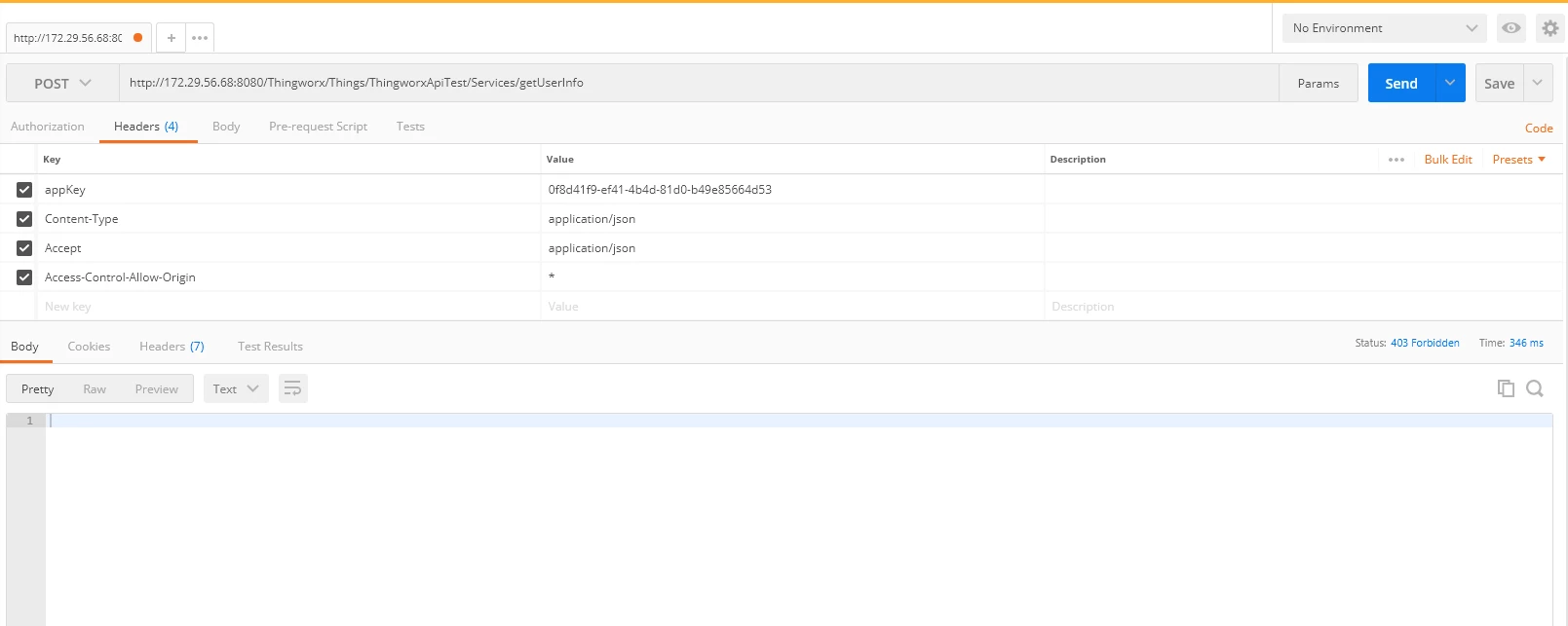

When i am trying to access the API using Postman i am getting 403 error.
For reference please check attached images.

hii Sharon,
 we have followed  https://www.ptc.com/en/support/article/CS229450  article that resolved our issue.

Hi @shubhamm.
Have you made any changes to filter for CORS based on any documentation PTC provides?  If so, please provide specifics on the changes that were made.
What versions of Tomcat/ThingWorx are you running?
Here is an article that may help depending on the ThingWorx version you're running.

Tomcat 8.5.32
Thinworx 8.3
