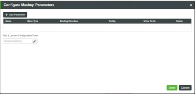

I have been facing an issue of internal exception 4
when i use the show/Hide log in that mashup page it displays an error like
'An error occurred while loading mashup "Mashup name" Expected string for parameter content, received null instead.'
But i have not used any mashup parameter
I have used three services in the mashup getproperties, querypropertyhistory and setproperties which is to get and set properties of a remote thing from kepware server
kepware server installed in same machine and i am using trial version of  8.5
Any suggestion?

@abdulrauvf ,
If you go to the Explorer tab you can select the "Mashup".
This will put the down arrow in the upper left corner of the mashup.
The drop down list has the following entries:
Select "Configure Mashup Parameters", Are there any parameters defined?  This could be the parameter that the error message is about.
Hope that helps
Peter

Hi @PEHOWE,
Thanks for your help,
I have not used any mashup parameter
initially i created a parameter after that i deleted it, I even created a new mashup by just copying the panel still the exception error is displaying
Abdul

October 26, 2020
If it can help you, I have such error (internal exception 4) when I have double slash in the URL and navigate between mashup !
For instance : http://mytwx//Thingworx ....
