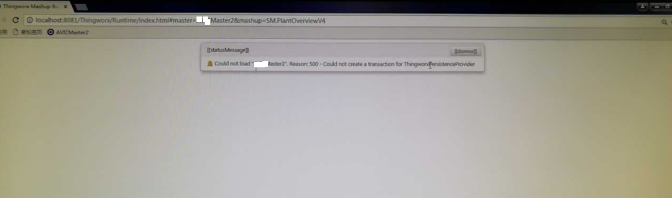

Could not load **Master", Reason 500, Could not create a transaction to Thingworx Persistance provider
Hi all,

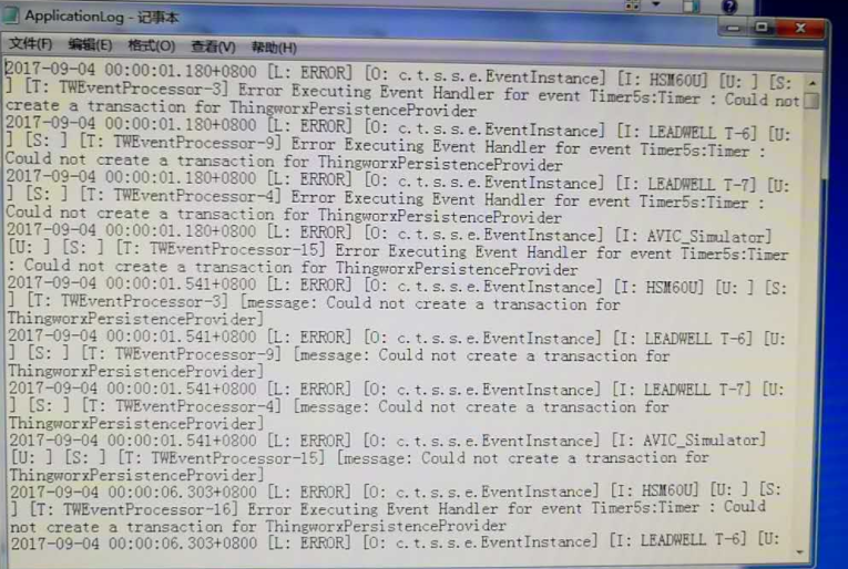

Do you meet this error? "Could not load **Master", Reason 500, Could not create a transaction to Thingworx Persistance provider. I open the Application.log and find the detail. How to solve this problem? Many Thanks.

I didn't use the PostgreSQL. There are some properties' values will be deleted when 12:00 p.m. So I call the Timer5s services as a subscription.

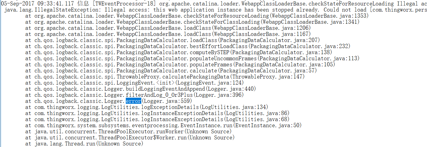

The issue will be disappeared if I restarted the Tomcat.  I connect the Thingworx with MySQL server. But they are in the same machines.

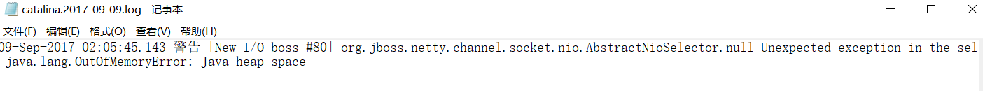

I check the initial memory pool and maximum memory pool of Apache Tomcat 8.0 Properties (Java). They are none. By the way, I didn't set the Java options.
If I set the java options as the following, I cant start the Tomcat. It will shut down automatic.

Hi Yijun, when you restart with those Java options what error message do you get in the Tomcat's catalina log? I think that needs to be fixed since we need those options for Tomcat. BTW, are you defining Xms and Xmx for the tomcat JVM?
