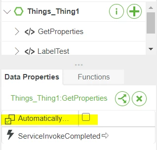

Here is the summary of what I am doing: I have an ANSYS Twin Model Connected to PTC on ANSYS Twin Builder using PTC Connector. The twin model has 1 input and 3 outputs. I was approaching the problem on 2 phases:
1- Using PTC "Thing" I can change the input, and the output change and I can see the update on the Mashup working fine (not continous update ofcurse)
2- Now, to make the work more realistic, I need to connect the physical model, to the twinbuilder to PTC. I origionally can run my physical twin using a Python code, and I can see the changes on the twin model.
I updated the Python code, so it connect to PTC and run the work. which seems to work. However, the issue here is the updates I see on the twin builder and on the python code, I do not see on the mash up.
I am connecting the gagues in the Mashup using the getproperties and setproperties. Am I missing somethig here that is needed as I am attachimg the physical model?

I am not familiar with ANSYS digital twin. So, I will try to help you on the ThingWorx part. In the mashup builder, if you click GetProperties, you will see under Data Properties tab there is a check box for Automatically update values when able. Could you please check this and test?

Thanks for your input.  I tried what you suggested, but it did not worl. Actually it affected the Mashup Gauges for the output and it shows nothing now.
BTW, in my mash up, I have a numeric Entry to manually enter the input, do you think I should remove that now?
