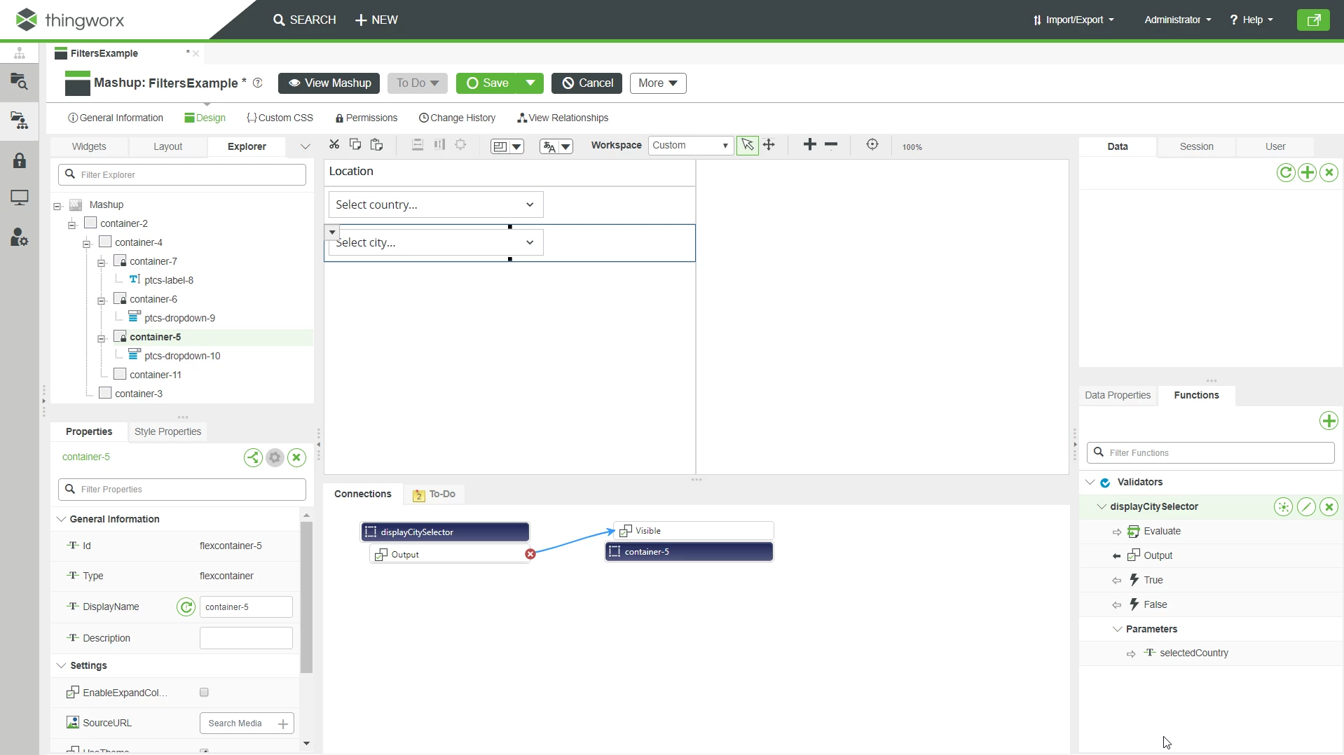

Hello @alenaromi,
What ThingWorx version do you use? If it's reasonably recent (at least 8.4), then you can just create a vertical container for the left side bar, break it into a bunch of sub-containers and put your filters into those. You can then show/hide the relevant filters via Validator functions, binded to Visibility properties of those sub-containers. I'm attaching a screenshot, demonstrating the concept.
/ Constantine
alenaromi1-VisitorAuthorAnswer
Thanks a lot.
I used containers and set expand and collapse options and it seemed to work.
