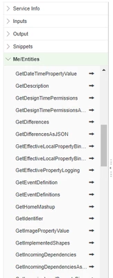

April 8, 2022
where can I find the service GetFileListingwithLinks? I can't find it either in Snippets or in Me/Entities 😞
April 8, 2022
You will find it on a repository thing:
// result: INFOTABLE dataShape: "FileSystemFileWithLinks"
let result = Things["SystemRepository"].GetFileListingWithLinks({
	path: undefined /* STRING */,
	nameMask: undefined /* STRING */
