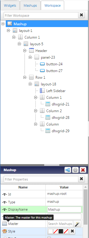

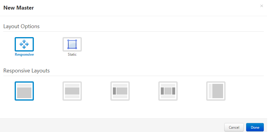

Hello Fabio Manniti​,
Yes, it is called Master - you can then create the common layout sections (e.g. header, sidebar).
The layout can be choosen when creating a new Master entity:
Then all you need to remember is to go to you mashup and set the Master in the Mashup properties.
