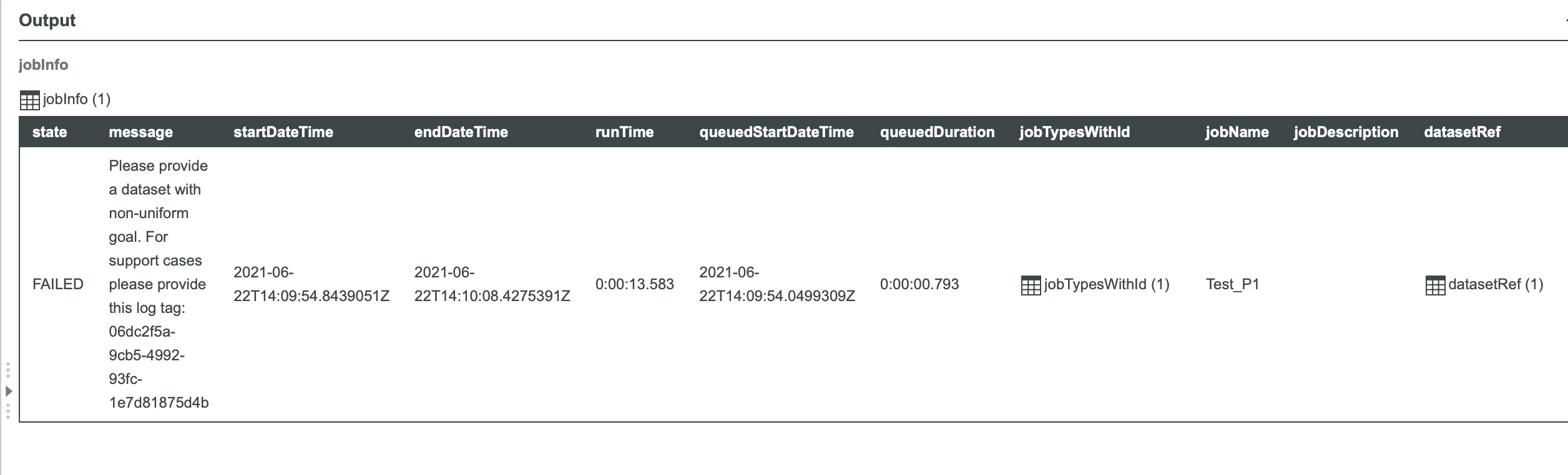

I am able to output a model ID but when I run it through the GetJobInfo() service under the Training Thing it shows that my model fails.

Hi @RS_9963079
Indeed one of the problem is that you do not have enough data, this is what the message tells us for the failed training job. It complains that all the goal value are identical, in fact here we have only one.
You need to add more data, I think a dozen can be enough and make sure the goal value differs between them.

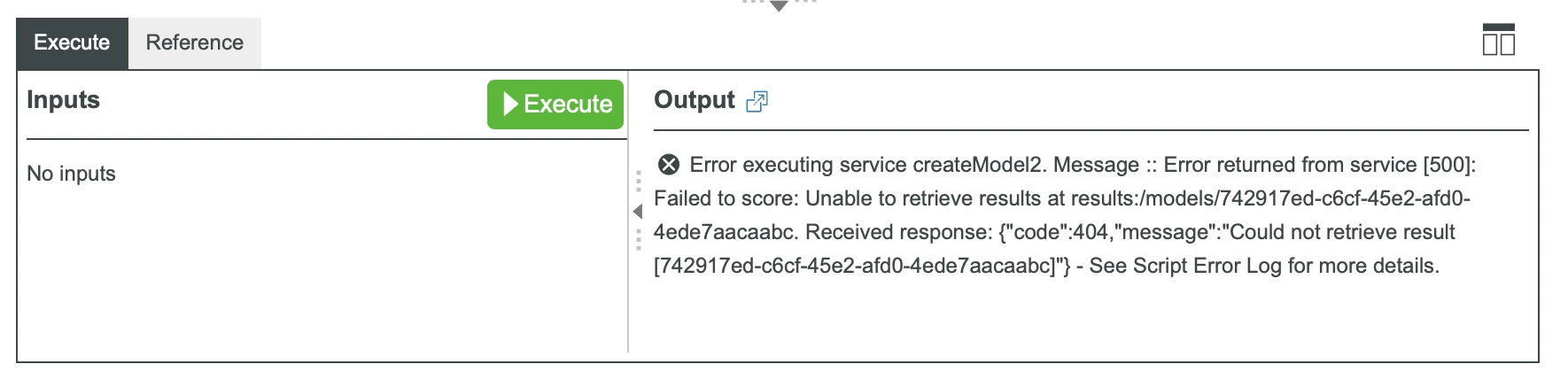

June 22, 2021
Can you tell me how I can access the Application and Script logs? I'm new to ThingWorx and have not been able to locate them.
I've attached the errors I receive when executing the service and when running getJobInfo.
When I click on datasetRef in the getJobInfo() service it appears as if no data has been stored there, but if I print
var result = datasetRef in my service and set the output to INFOTABLE, I am able to see my data.

You wrote that  you can see the data when you use
Could you please post the data you are see ?
Also could you post the call of the CreateJob service with the input parameters, especially the goal.
