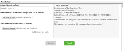

Create Dataset in Analyticsserver, SSLException: Unrecognized SSL message, planetext connectio
I Am testing the Analytic Trial, I make the CSV and JSON download from the developer site (analytics_vibration - https://developer.thingworx.com/resources/guides/analytics-builder-quickstart/data-upload).
I Try to create a new dataset, I choose the files and click on submit, then the error below happens.
My Analytics Server configuration is like below.

Mar 22, 2018 2:44 PM UTC
Hi Christophe
I tried again without the SSL, but now I Unchecked the SSL access, restarted the server and tried again. Now it worked.
Before I did not restart the server.
Thank you.

Mar 22, 2018 1:46 PM UTC
Hi
Could you confirm if your ThingWorx server is using https ?
Can you upload <ThingWorxAnalyticsServer>/config/analytics-server.properties and  <ThingWorxAnalyticsServer>/config/system-environment-variables.properties
Christophe
Mar 22, 2018 2:00 PM UTC
How can I confirm if i use HTTP or HTTPS?
For access the Composer I use only HTTP. I am using the trial version, so it's running on DockerMachine.
Follow attached the files.
Thanks.
Mar 22, 2018 2:06 PM UTC
Hi
Ok so you are using HTTP.
In this case in ThingWorx Analytics Builder > Settings, uncheck the box for SSL access under the Thing Name since you are not using SSL.
Then save the settings and try again
