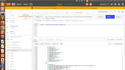

I'm using REST API to automate my application with TW Analytics. I've succesfully uploaded CSV and JSON files to AnalyticsUploadStorage using CreateTextFile service. However when creating a dataset with the uploaded files using /Thingworx/Things/AnalyticsServer_Thing_DataThing/Services/CreateDataset which gives 200 OK, but the job fails with following error in the GetJobInfo api response: ProtocolException: The server failed to respond with a valid HTTP response
Creating dataset through Analytics Builder works fine but I require REST API for automating. When I look at the call that the AnalyticsBuilder is using, its the CreateDatasetAMS service of the TW_ML_Helper Thing. Using that in postman also gives 200 OK but the subsequent GetJobInfo returns with the same error.

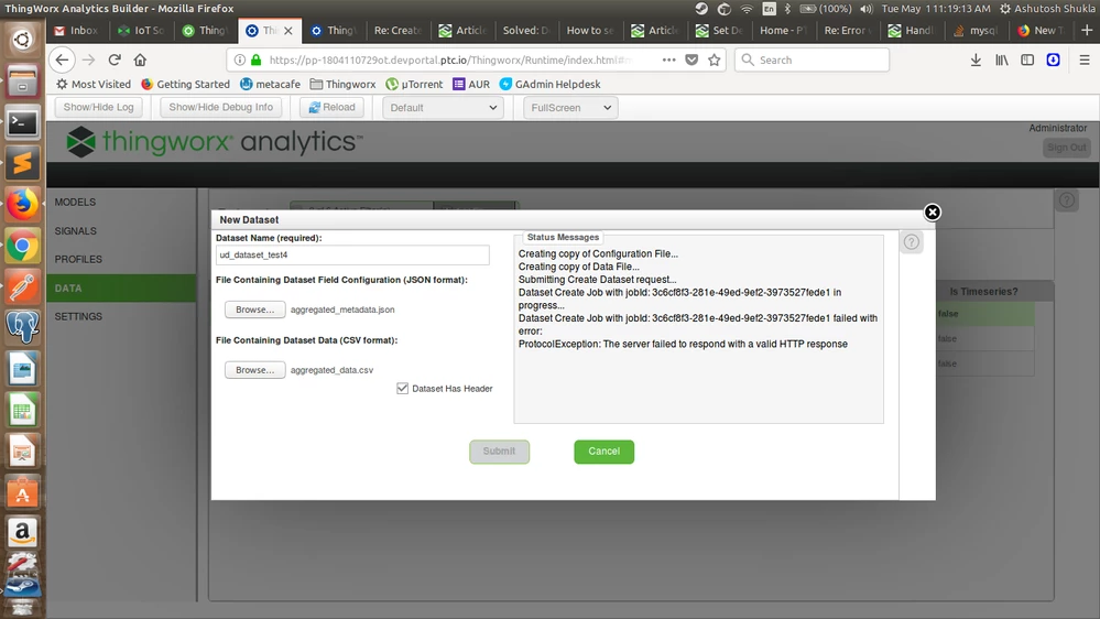

Best answer by cmorfin
Hi
I was talking to the DevZone team but it appears that the hosted instances are not meant to be used with Analytics as there are some known issues.
Instead all the Analytics Quickstart Guides point to use the Analytics Trial Edition (ATE) that is downloadable from  https://developer.thingworx.com/resources/downloads .
I understand that it used to work but unfortunately there is no support from the DevZone team for the analytics component on the hosted instances.
So the best way forward for you is to download and install the ATE.
Hope this helps
Kind rgeards
Christophe

https://<serverIp>/Thingworx/Things/AnalyticsServer_Thing_DataThing/Services/GetJobInfo?appKey=<appKey>
Request Body:
{"jobId": "<jobId>"} return above error.

Hi @cmorfin,
Now I'm getting this error in Analytics Builder also.
Plz help...My application has stopped working now...
