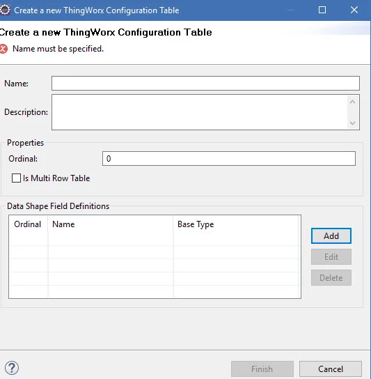

Hi @Sathishkumar_C not sure if you have already tried, is this not working when you create Configuration Table? This creates the datashape fields

Hi @Sathishkumar_C configuration table option which i mentioned would be if you have like a configuration section in your entity.
If you are just looking to create a data shape you can invoke the EntityServices function CreateDataShape()
