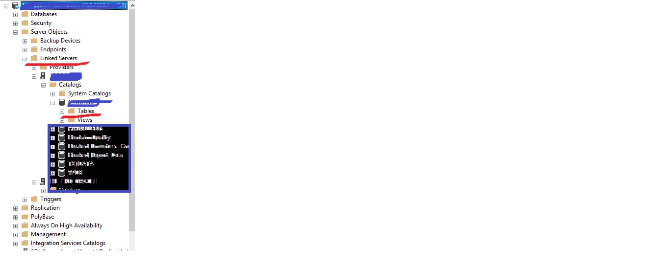

Can anyone help me to understand how to write details for the linked server create engine.
What exact details needs to be mentioned here.
SERVER = ''
DATABASE = ''
DRIVER = 'SQL Server Native Client 11.0'
USERNAME = ''
PASSWORD = ''
DATABASE_URL = f'mssql://{USERNAME}:{PASSWORD}@{SERVER}/{DATABASE}?driver={DRIVER}'
engine = create_engine(DATABASE_URL)
connection = engine.connect()
And i need to use this while doing dataframe.to_sql(). Because when we pass table name along with linked server ip.schema.tablename it throws error.

December 10, 2020
Thank you for the detailed information. But my problem is, I'm able to write dataframe to DB table but in this scenario it is creating table in the server given. But i need the data to be inserted to the linked server.
Here is example :
SERVER = 'ABC'
DATABASE = 'ZZZ'
USERNAME = ''
PASSWORD = ''
and now Table 'Test' is in a linked server('123') to 'ABC'.:
SERVER = '123'
DATABASE = '456'
Table = 'Test'
So when i do df.to_sql(tablename = 'Test') , it loads data in 'ZZZ' database of server 'ABC' where in I need the data in database '456' of server '123'- which is a linked server to 'ABC'
