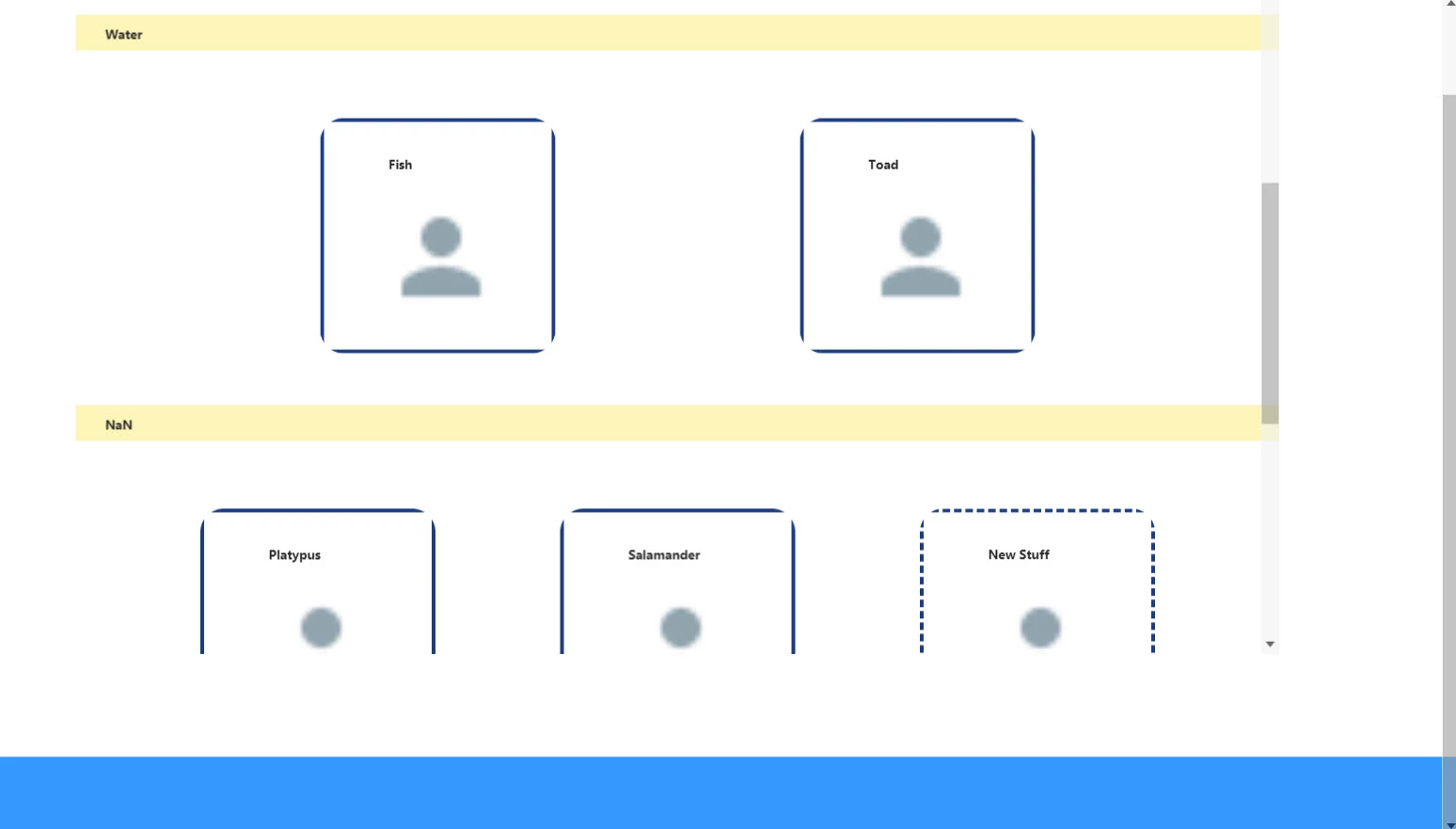

When I use the Master, it created a footer at the bottom of the window, I would like a footer that is at the end of the page, you can only get to it when you scroll all the way down, and then it is at the end (very similar to how it is here on the community site). Does anyone have suggestions on how to do this without having to add it to every single page, and still have the benefits of using the Master for the header?

Update: I've tried with the Collection widget, it is still not giving the desired results. If I try using the "Footer" feature within the Collection widget, it adds it at the end of every section, which I would only want it on the last section. I also tried to be clever and nest Collection Widgets, but it also did not work, there is still a scroll bar for the nested collection widget, meaning that there are two scroll bars, one for the whole page, and one for the nested collection widget itself. (see attached picture)
