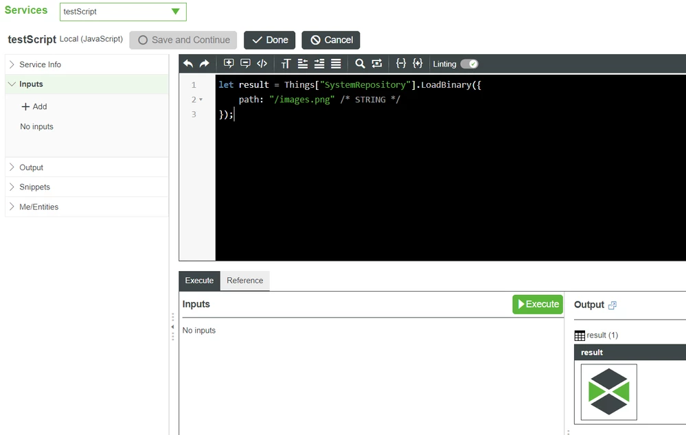

Hi @Yoshihiko.N
You are trying to convert base64/binary data again to base64 string
Output from LoadBinary can be directly viewed as an Image
let result = Things["SystemRepository"].LoadBinary({
	path: "/images.png" /* STRING */

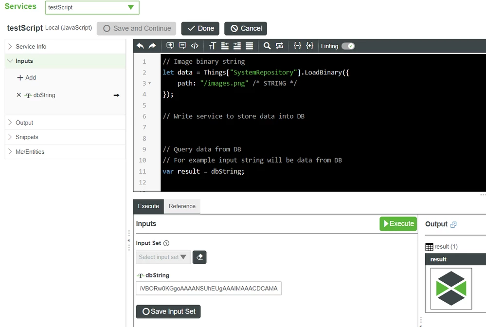

In your use case :
// Image binary string
let data = Things["SystemRepository"].LoadBinary({
// Write service to store data in DB
// Query data from DB
// For example : input dbString will be data from the DB
var result = dbString;
/VR
Oct 2, 2023 5:22 AM UTC
Hi @Yoshihiko.N
Set the result output type to Image

Oct 2, 2023 6:48 AM UTC
Hi @Yoshihiko.N
In your use case :
/VR
