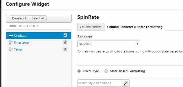

Dec 12, 2018 8:04 AM UTC
Click on Grid widget, expand the triangle on top left of the widget, open Configure Grid Columns
for each column, you can also assign different State Formatting
