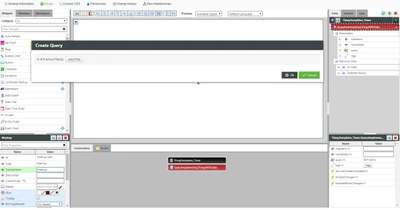

In version 8.3.2, when I select a service like QueryImplementingThingsWithData on a ThingTemplate, next query I can click Edit Query. It open a popup Create Query with a Add Filter button.
When I click on the Add Filter button, I can select on a list a field and define my query. OK no problem !
When I do the same on a Thingworx version 8.4.3 or 8.4.5, when I click on the Add Filter button, nothing happen ! There is no list with my fields that is displayed and I can't define my query.
For information, in Chrome console, I don't have error.
Does anyone have the same problem ?

Hi @Ju_01 ,
This issue is already reported as a bug to our R&D team and this issue is fixed in Thingworx version 8.5.
Vibhuti
