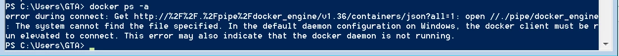

The docker ps output is the key here. It shows that the nginx container is running on port 9800 instead of the default port 80. This will happen if the port 80 is in use when you perform the installation.
You should be able to fix this by following the steps in https://www.ptc.com/en/support/article?n=CS273969
Note though only update the properties that already exist in your config files, do not add any. The above article was written in 8.1 and some properties were present that are not needed anymore in 8.2.

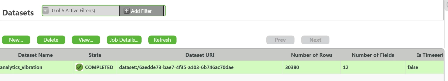

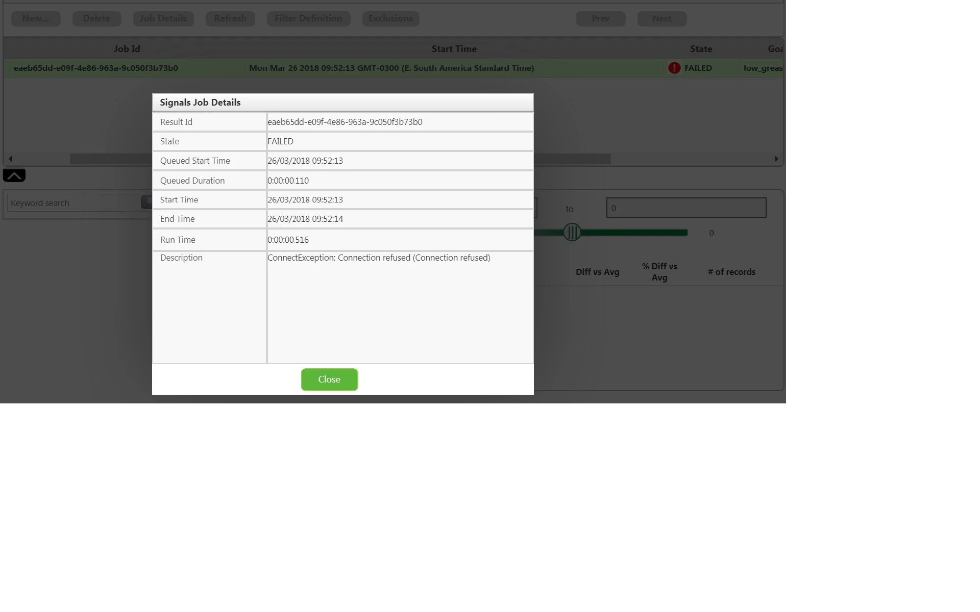

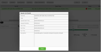

I Don`t know what happens with the message.
Hi,  I Am testing the Analytic Trial, I make the CSV and JSON download from the developer site (Build a Predictive Analytics Model - analytics_vibration -   https://developer.thingworx.com/resources/guides/analytics-builder-quickstart/data-upload) and created a datat set.
When I Try to create a Signal or a Profile, It return failed. Connetion Refused.
The ThingWorx is the Trial version and I Am Running on DockerMachinePTC.
Thanks.

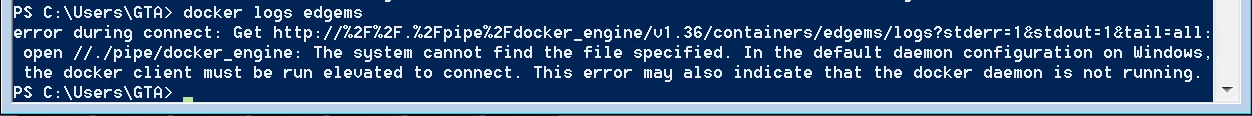

Could you post :
- the dockerps.txt output file created by executing the command docker ps -a > dockerps.txt
- the edge.txt output file created by executing the command docker logs edgems > edge.txt
- a zip of <UserProfile>/twx-analytics/logs
-ThingWorx ApplciationLog.log file
Also are you able to create a predictive model ?

Mar 26, 2018 4:21 PM UTC
Yes, I made the full installation, all together.
My windows is Windows 7 Ultimate SP1.

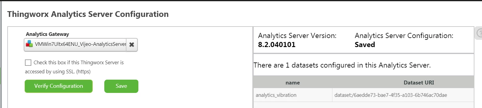

One Thing is weird, on Power Sheel when I use the commad "docker-machine ls" my machine Status is Timeout, when I open the Virtual Box My Machine Status is aborted, howerver I Can connet to ThinWorx Composer and when I click on "Verify Configurarion" on "Analytic Builder" the status is Ok.
The Files is attached.
I Am not familiar with DockerMachine, How can I extract the "AplicationLog.Log" from it?
I have the same error when I try to create the Signals, the profiles and the model.
