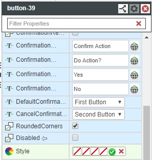

1. Overlap the Button widget with the ValueDisplay widget, put it in top-right corner.
2. Change the Button Style with a X image  (I don't have that at hand, use another one)
3. Figure out the "Close/ delete image" logic in a service and trigger it by this Button.  (Don't know how you want to delete image in ValueDisplay, so you need to do the customization yourself)

Yes you can, the Button widget can overlap with the valueDisplay widget, and occupy the top-right part of the image.
And then, you need to change the Button Style with a X image, and figure out the "Close/ delete image" logic in a service and trigger it by this Button.
