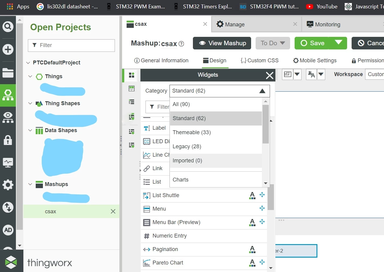

Created An widget Extension jdk11.0.13 imported in composer(couldn't showing in mashup widget panel)
Created An widget Extension with ( jdk11.0.13version ) and imported in composer. its showing successfully imported.
In mashup widget panel->>ALL->>imported(0).
IDK why??

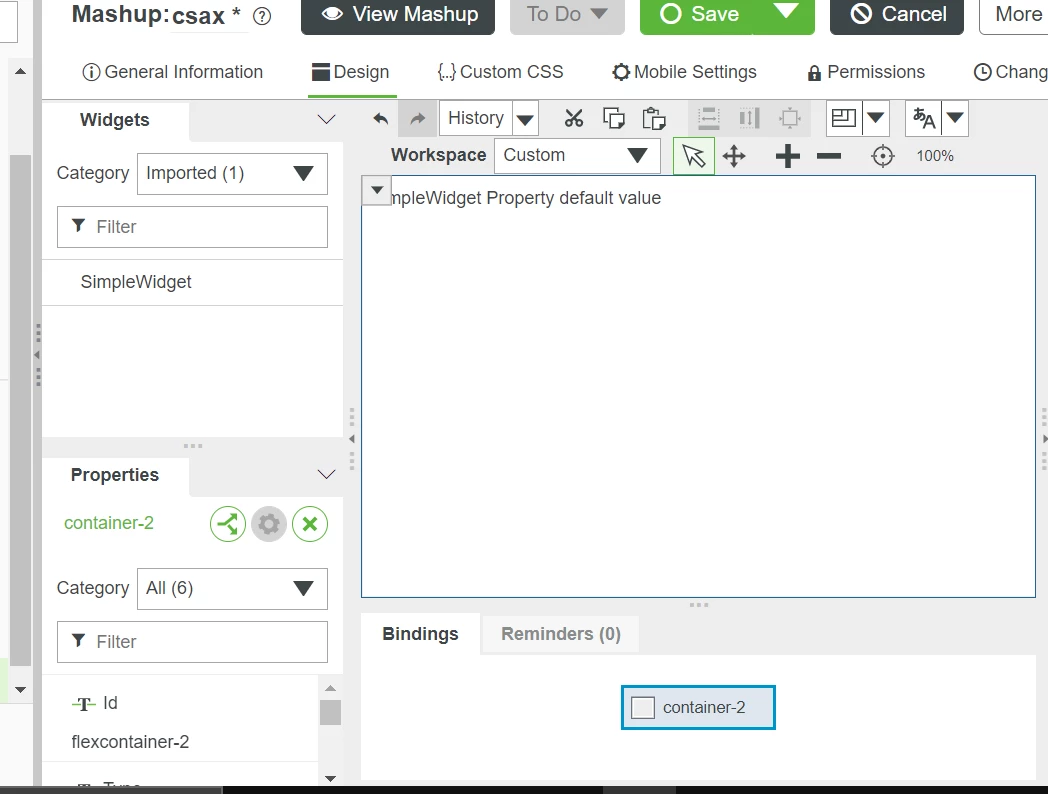

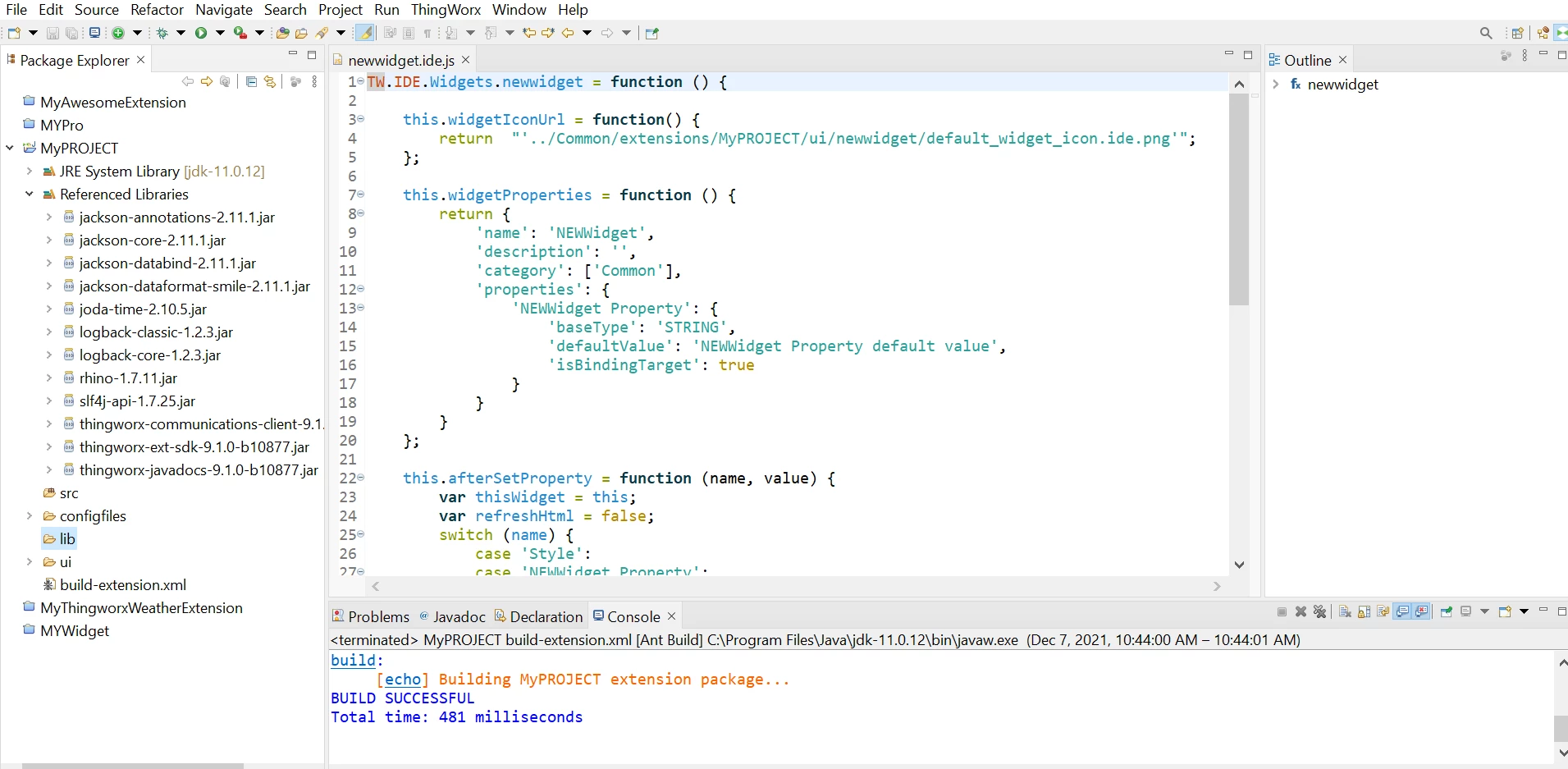

    as you mentioned  step3 : i found that i develop that widget in Eclipse "enterprise java & web developers" but it can't work in this env.
    so i tried that another eclipse "java developers package "so its working on that. IDK why ???

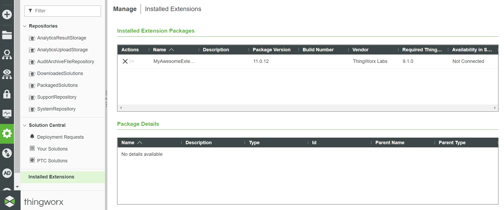

    In screenshot(14) can you select the extension at the top and make a new screenshot? In the bottom it should show your widget in "Package Details"
    - If there is a widget shown: Did you refresh Composer after the extension was imported (like it prompts you after import)?
    - If there is no widget: There is something wrong with your eclipse project
