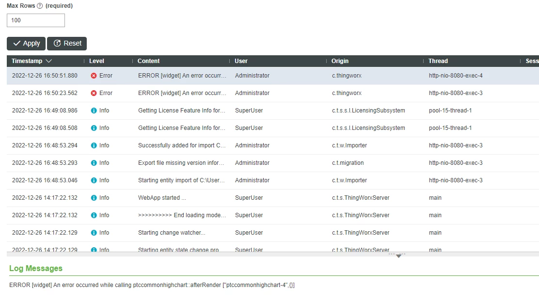

created extensions do not works in thingworx 9.2
hello
I installed thingworx 9.2. And the sdk of the extension function used in the 8.5 version was applied to the 9.2 version and imported. but, the extension doesn't work with this error. If anyone knows of a similar error or solution, please reply.
ERROR [widget] An error occurred while calling ptccommonhighchart::afterRender ["ptccommonhighchart-4",{}]
thanks

Hi @YC_9410522.
With 9.x, widgets are designed around web components.  Here is the link with more information.
If you have any questions after reviewing the link, please let us know.
Regards.
--Sharon
