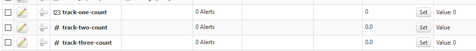

I then create an additional property that will keep the values.

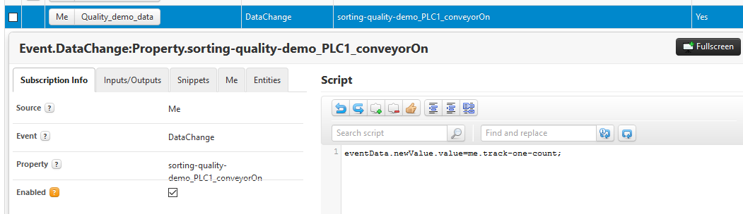

I created the subscription on data change as such

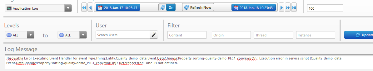

I went in circles trying to figure out why its not working. then I had a look at the application logs.
Throwable Error Executing Event Handler for event Type.Thing:Entity.Quality_demo_data:Event.DataChange:Property.sorting-quality-demo_PLC1_conveyorOn : Execution error in service script [Quality_demo_data Event.DataChange:Property.sorting-quality-demo_PLC1_conveyorOn] : ReferenceError: "one" is not defined.
This made no sense to me at all so I tried with track two and three. And got similar errors.

I thought could it be the name of the parameter?

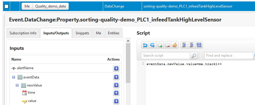

I created another parameter called track1 and did the same thing.
And now its working.

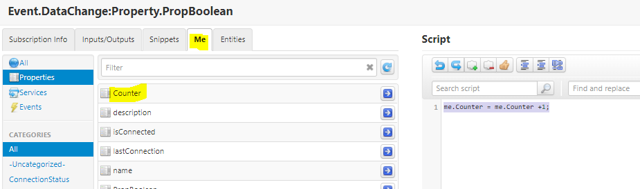

Bryan Kirchner​:  From the details it is not clear where exactly variable "one" been used as it is giving ReferenceError: "one" is not defined. I think the way you are assigning values in subscription could cause the issue. You can directly increment the property with something like this:
me.Counter = me.Counter +1;
Go to Me tab and use the property which you would like to increment in event of Boolean property change.
-Durgesh

I did all of that. The Issue in the end was related to the name of the service ​because it had " - " in it.
As soon as I renamed the service to "track1" instead of "count-track-one"
it worked
