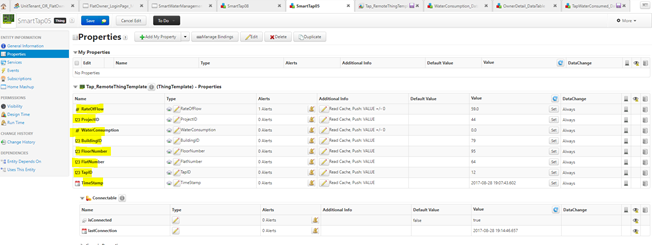

ScreenShot of Properties of a Tap in A flat are as follows :

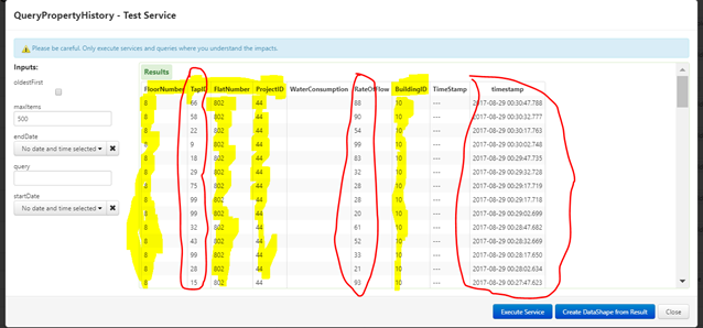

Data coming from Taps are stored in value Stream , Screenshot of Value of Stream is follows:
As we can see clearly , Currently , we have different TapIDs which have Water Consumption in one Flat (#802) which is in building (10 ) and the building is in Project (44).
So , For a Flat , TapID and Rate of Flow of Water through the tap may change and we have calculate the Water Consumption based on this .
