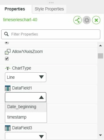

I am new at Thingworx and I am basically trying to set up a Time Series Chart to display my RPM on the Y-Axis and the date (HH:MM) on the X-Axis.
Now my questions:
  • Which Service should I use to get my Properties (for example GetPropertyValues, QueryPropertyHistory,...)
  • How are the Bindings on the the Chart
I found a YouTube Tutorial according to this topic, but unfortunaley this was for an older version of the Composer.
I hope someone can help me here because I can't find any solutions for my questions.

I suggest to use QueryPropertiesValues, as this will give you a history of values (need to have logged properties in a value stream).
You can bind QueryPropertiesValues result to Data of the Time Series Chart. After this, check the properties of the chart and set them as you need.

I already tried to bind the QueryPropertyHistory to the Data of the Time Series Chart but I can only see a timestamp, but not my Properties. The Property which I'd like to bind to the Chart is a NUMBER.
Greetings
Sebi8200

Is that property type number logged in a value stream?
Value Stream needs to be put at the level of the Thing or Thing Template.
