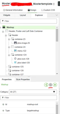

Hi all,
I'm currently using ThingWorx 9.1.8-b845 and I have a problem when I want to create a mashup parameters in a Master Mashup. The gear symbol is unclickable (see picture below). Does it mean that I can't create mashup parameters in a master mashup?
Best regards
Best answer by TravisPickett
Masters do not support mashup parameters since they are intended to be used with multiple child mashups.
Depending on what you are trying todo, you can potentially use session parameters.
22-Sapphire I
October 24, 2022
It is showing that you opened a Master vs. a Mashup.
I believe Masters do not support mashup parameters
November 4, 2022
