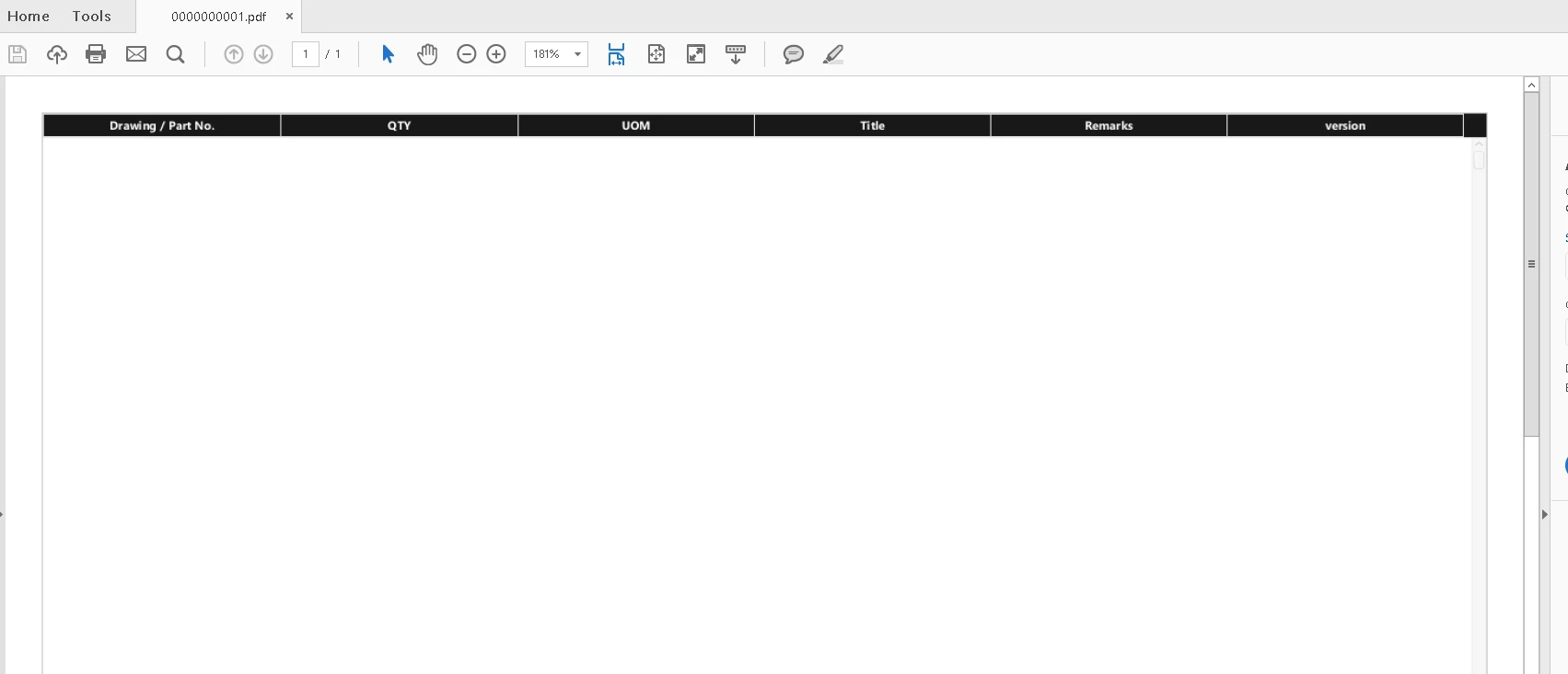

I then click another 'CreatePDF' button where I want it to create a PDF of the populated data, however, when I use the 'CreatePDF' button it only creates a file showing empty tables and does not create a pdf of the updated/populated mashup tables.

Correct, the tree table is completely empty in the pdf file.
I've attached two screenshots; one of the mashup preview, the other the pdf created from it.
Note: The tree table is in a contained mashup with the 'createpdf' server address pointing to that mashup URL, hence the pdf file only shows the table. (not sure if that makes a difference?)

There is no problem if the tree is in contained mashup .I had a grid in contained mashup and tried the same use case and in the pdf i am getting table with data as well .Can you try executing the service from resource directly .I mean don't try to run it from mashup button .Directly go to PDFExport resource and test the createPDF service by passing the attributes directly there .I am hoping you are passing the thingworx username which has permissions to execute the services and visibility to all entities involved in mashup .
