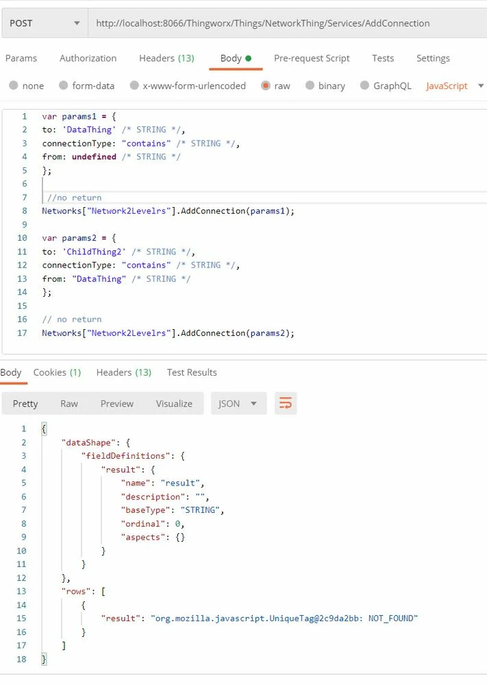

Hello @SO_9699370,
If you want to build the hierarchy in the network for the things that are created in ThingWorx you can do that with Postman. You can use Javascript in Postman, you can try the following example:

Hello @SO_9699370 ,
Have you tried with the URL in the following format:
http://XXX.XXX.XXX.XXX:8080/Thingworx/Things/TestNetwork/Services/AddConnection

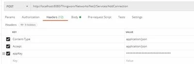

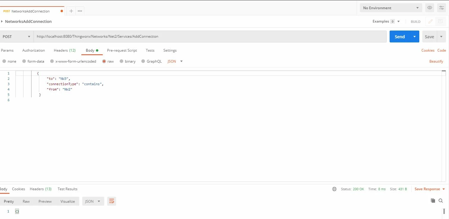

Your Postman request looks OK, given that there are no typos somewhere in your postman params http://localhost:8080/Thingworx/Networks/Net2/Services/AddConnection
At least, it works as expected on my side, I even copy&pasted the code from your message.
Very unlikely, but just in case, check the headers
Other than that... 500 is pretty generic error. What's there in the Application.log?
