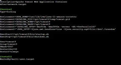

I’m facing a database connectivity / connection pool checkout timeout issue during ThingWorx Foundation startup against AWS RDS PostgreSQL 16.6. ThingWorx goes into ERROR state even though database connectivity works from other clients.
Environment
  • ThingWorx Foundation: 9.7
  • OS: Ubuntu 22.04
  • Database: AWS RDS PostgreSQL 16.6
  • App Server: Tomcat 9.0.113
  • Java: Amazon Corretto 11.0.29
    • Path: /usr/lib/jvm/java-11-amazon-corretto
Error Seen (Startup)
ThingWorx fails on startup and sets the web app state to ERROR:
*** CRITICAL ERROR ON STARTUP: An attempt by a client to checkout a Connection has timed out. *** Web Application STATE is being set to ERROR! ***
This looks like the ThingWorx DB pool is unable to checkout a connection within the timeout (pool exhausted / blocked / cannot create new connections).

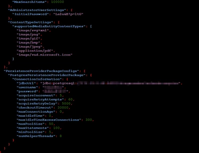

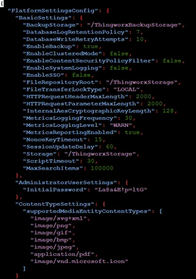

What I’ve checked / tried
  • Verified DB host/port/security group rules (DB reachable).
  • Verified credentials configured in platform-settings.json.
  • Reviewed multiple community articles about DB connectivity and PostgreSQL.
  • Restart attempts still intermittently lead to the same startup failure.

  2. What are the recommended ThingWorx DB pool (c3p0) settings for:
    • maxPoolSize, minPoolSize, checkoutTimeout, acquireRetryAttempts, etc.
      to avoid startup failure?

Hello @Rajkumar_20673,
I hope you are doing well.
Are you using AWS RDS (PostgreSQL) as a primary persistence provider (DB) for ThingWorx?
If yes, please note that PTC does not support AWS RDS as the primary persistence provider for ThingWorx 9.X. For detailed information, kindly refer to this KB article.
  • Notes:
    • AWS databases can be used as secondary databases to store IoT data collected by ThingWorx.
    • To use AWS databases as secondary databases, please follow the instructions provided in the article “How to Connect to Database in ThingWorx.”
Additionally, for more details regarding the compatibility of ThingWorx Platform 9.7.0, please review this release advisor.

Dec 27, 2025 3:21 PM UTC
I suggest you validate your *JDBC connection string*, not connectivity. Since you blurred it out, we don’t know if the syntax is valid, if there are any extra flags like ssl, etc. Besides, JDBC uses a different Postgres driver.
