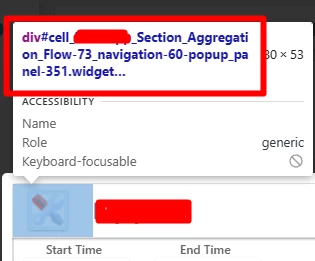

I face this problem daily, so for the CSS you have applied, you need to put the #root before it. The #root you will get it when you open the popup from runtime and do an inspection on it.. for example:
So you need write code like:
#cell_Section_Aggregation_Flow-73_navigation-60-popup_panel-351 {
 background: transparent;
 -ms-filter: progid:DXImageTransform.Microsoft.gradient(enabled=false);
 filter: none;
 border: none;
 filter: none;
 border: none;
